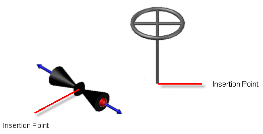

Valve Operators (Actuators)
When creating a valve actuator, set the insertion point of the actuator to match the insertion point of the valve body. In plantpartconvert, select the actuator block and use the Exit option. Because an actuator has no ports, you do not use the Add option.
If you set block object color to BYBLOCK, the component supports automated layer and color assignment.
