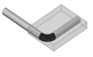

Summary
The model is displayed in a temporary drawing with the OrthoCube. You can define new ortho views of the model and specify the boundaries and placement of the views.
