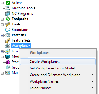

  2. You know that between the first and second toolpath you will need a 5-axis link move. However, you don’t know the exact orientation of this workplane, so create a new workplane by selecting Create Workplane from the Workplanes context menu:

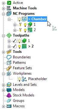

  4. Drag the workplane between the two toolpaths in the NC program:

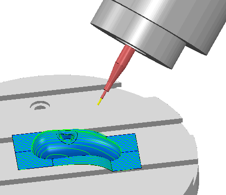

  8. Move the machine tool to the end of the first toolpath, using Simulation tab > Simulation Controls > Step Forward (or using the simulation keyboard shortcuts).
  9. Click Simulation tab > Position dialog > Machine Tool to display the Machine Tool Position dialog.
  10. Use the axis sliders on the Machine Tool Position dialog to jog the machine to the desired position for the link move.

    The Placeholder workplane is now in the required orientation:
