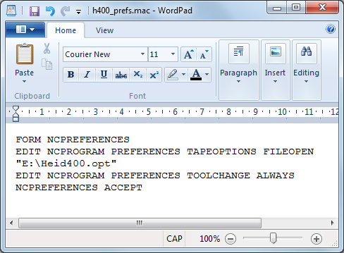

You can edit recorded macros to troubleshoot and correct any errors.
  1. Expand Macros and select the macro you want to edit.
  2. From the individual macro menu, select Edit.
    A Windows WordPad document opens.
    The text editor opened by default is the application associated with macro (.mac) files. Use the Choose default program option available in Windows Explorer to make changes to default file type associations.
  3. Edit the macro commands, and then save the file.
