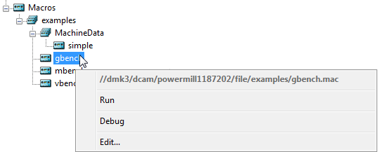

When you run a macro, the commands recorded in the macro file are executed.
  1. Expand Macros, and select the macro you want to run.
  2. From the individual macro menu, select Run.
You can also run a macro by double-clicking its name in the Explorer.
Running the macro you have just recorded
The location of the macro you have just recorded becomes the local folder. So, the macro you have just recorded is available in the local macro search path icon. However, the list of macros is not updated dynamically. To force an update:
  1. Click icon next to Macros to collapse the contents.
  2. Click icon next icon to Macros to expand and regenerate the contents.
  3. Click next to to see the macros in this directory, which includes the one you have just created.
