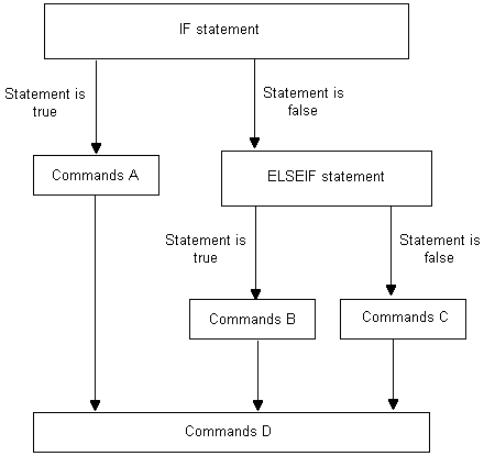

The IF - ELSEIF - ELSE statement executes a series of commands when a certain condition is met, a different series of commands when the first condition is not met and the second condition is met and a different series of commands when none of the conditions are met.
The basic control structure is:
IF <expression_1> {
    Commands A
}   ELSEIF <expression_2> {
    Commands B
}   ELSE {
    Commands C
Commands D
If expression_1 is true, then Commands A are executed followed by Commands D.
If expression_1 is false and expression_2 is true, then Commands B are executed followed by Commands D.
If expression_1 is false and expression_2 is false, then Commands C are executed followed by Commands D.
Tip: ELSE is an optional statement. There may be any number of ELSEIF statements in a block but no more than one ELSE.
