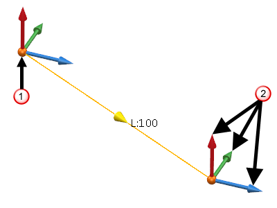

Graphically editing a line (workplane handles)
  1. Select a line.
  2. Right-click the line and select Workplane graphic handles from the context menu.
  3. To edit the line, drag the handles:
    • Use the workplane spherical handles to move a line point freely.
    • Use the workplane arrow handles to move a line point along a fixed axis.
Note: Moving the cursor over a handle highlights the handle, indicating that you can move it.
