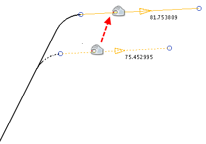

    The two lines either side of it can be trimmed or extended to fit the fillet arc:
  3. Click and drag to move the position of one of the lines.
    The arc and the other line update too:
