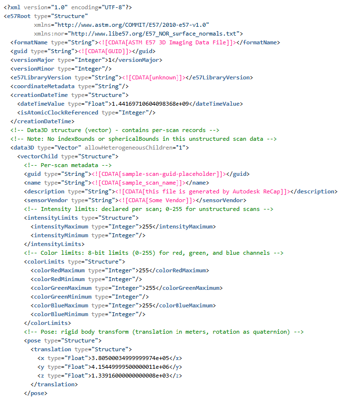

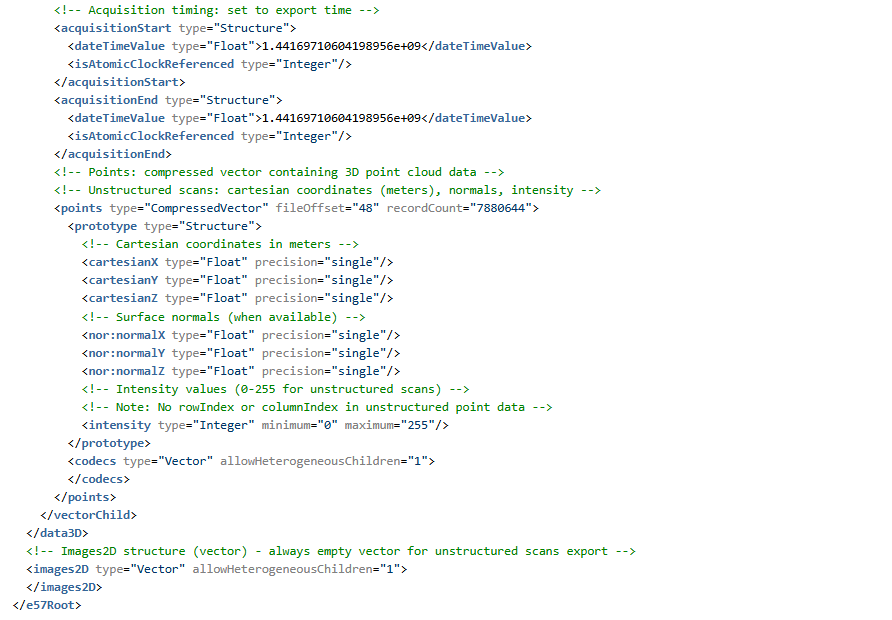

Unstructured scans
ReCap exports unstructured scans only with the Data3D object.
Header information:
  • formatName (string)
  • guid (string)
  • versionMajor and versionMinor (integers)
  • creationDateTime
Data3D structure (vector):
  • guid (string)
  • name (string)
  • description (string)
  • sensorVendor (string)
  • intensityLimits (structure):
    • intensityMaximum (integer)
    • intensityMinimum (integer)
  • colorLimits (structure):
    • colorRedMaximum (integer)
    • colorRedMinimum (integer)
    • colorGreenMaximum (integer)
    • colorGreenMinimum (integer)
    • colorBlueMaximum (integer)
    • colorBlueMinimum (integer)
  • pose (structure):
    • translation (structure):
      • x (float)
      • y (float)
      • z (float)
    • rotation (structure):
      • w (float)
      • x (float)
      • y (float)
      • z (float)
  • acquisitionStart (structure):
    • dateTimeValue (float)
    • isAtomicClockReferenced (integer)
  • acquisitionEnd (structure):
  • points (compressed vector):
    • cartesianX (float)
    • cartesianY (float)
    • cartesianZ (float)
    • colorRed (integer)
    • colorGreen (integer)
    • colorBlue (integer)
    • intensity (float)
    • normals (float)
XML sample:

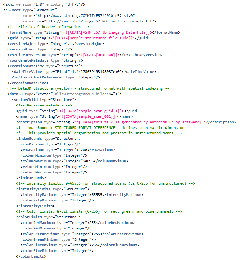

3D point cloud only (all edits) Option
ReCap converts structured dataset into unstructured and exports point cloud data only (Data3D). For the output structure, feel free to refer to Unstructured Scans section.

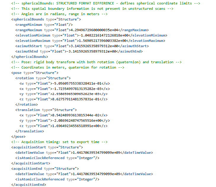

Structured point cloud only (no edits) Option
For this option, ReCap exports point cloud with structured information (index bounds) but without imagery representation included.
Main differences between structured and unstructured format are highlighted in bold text.

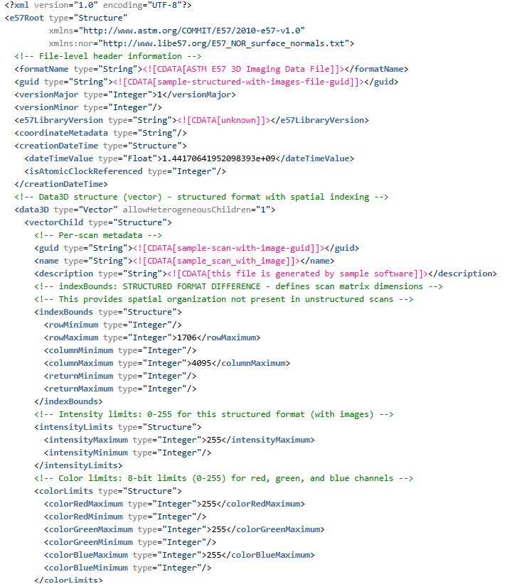

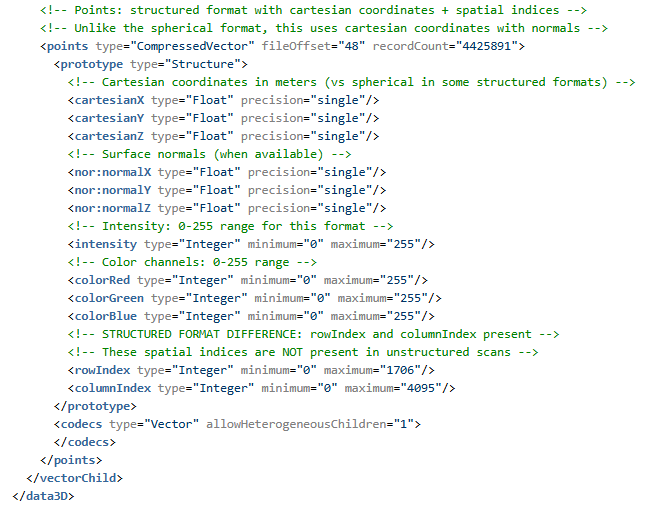

Header information:
  • guid (string)
  • creationDateTime
  • guid (string)
  • name (string)
    • indexBounds (structure):
    • rowMinimum (integer)
    • rowMaximum (integer)
    • columnMinimum (integer)
    • columnMaximum (integer)
    • returnMinimum (integer)
    • returnMaximum (integer)
  • sphericalBounds (structure)
    • rangeMinimum (float)
    • rangeMaximum (float)
    • elevationMinimum (float)
    • elevationMaximum (float)
    • azimuthStart (float)
    • azimuthEnd (float)
  • pose (structure):
      • x (float)
      • y (float)
      • z (float)
      • w (float)
      • x (float)
      • y (float)
      • z (float)

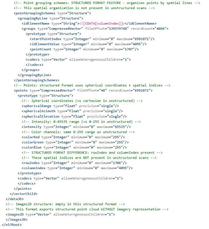

  • pointGroupingSchemes (structure):
    • groupingByLine (structure):
      • idElementName (string)
      • groups (compressed vector)
    • rowIndex (integer)
    • columnIndex (integer)
    • intensity (float)
XML sample:

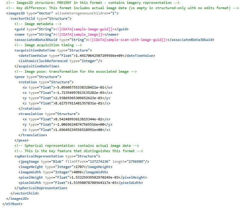

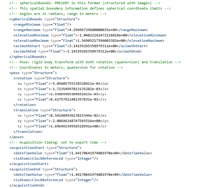

3D point cloud + panorama image (all edits)
For this option, ReCap exports point cloud data and imagery representation of the scan.
Structure:
Header information:
  • guid (string)
  • creationDateTime
  • guid (string)
  • name (string)
  • pose (structure):
      • x (float)
      • y (float)
      • z (float)
      • w (float)
      • x (float)
      • y (float)
      • z (float)
    • intensity (float)
    • normals (float)
    Image2D structure (vector)
  • guid (string)
  • name (string)
  • associatedData3DGuid (string)
  • acquisitionDateTime (structure)
  • pose (structure):
      • x (float)
      • y (float)
      • z (float)
      • w (float)
      • x (float)
      • y (float)
      • z (float)
  • sphericalRepresentation (structure):
    • jpegImage (blob)
    • imageHeight (integer)
    • imageWidth (integer)
    • pixelHeight (float)
    • pixelWidth (float)
    XML sample:
