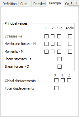

Select the Principal tab in the Panel cuts dialog to display the following options.
The following quantities may be selected for presentation.
- Stresses: s1, s2 and s12 as well as the angle
- Membrane forces: N1, N2 and N12 as well as the angle
- Moments: M1, M2, M12 as well as the angle
- Shear stresses t12
- Shear forces Q12.
