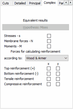

Select the Complex tab in the Panel cuts dialog to display the following options.
The following quantities may be selected for presentation.
- Stresses - s
- Membrane forces - N
- Moments - M.
The Hypothesis ( to select a hypothesis according to which the reduced values will be calculated button is not currently available. Complex results for slabs and shells are determined only according to the von Mises hypothesis.
At the bottom of the dialog you can select the calculating method for reinforcement (Wood&Armer, NEN code) and Mxx and Myy (for upper and lower reinforcement) determined during reinforcement calculations for slab and shell structures.
