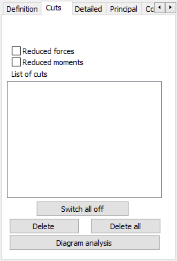

Select the Cuts tab in the Panel cuts dialog to present reduced forces and moments.
The software allows reduction of all forces acting in the section toward one point that is the center of gravity of a section. Reduced forces are represented:
  • in the graphic viewer: in the global coordinate system
  • in the result table that displays after clicking Diagram analysis: in the global and local coordinate systems.
The method of calculation of values of reduced forces and moments is included in the topic Reduction of forces to the center of gravity of a....
List of cuts presents all the cuts defined for a structure and specific information.
  • Display of the cut is toggled on or off for the structure. If selected, the cut will be presented on the structure together with the selected diagrams of the indicated quantities.
  • Color of the cut and the diagram presented for the cut.
  • Cut name.
Clicking Apply offers the following buttons.
  • Switch all off - Switches off the presentation of all cuts prepared for the current structure.
  • Delete - Deletes the selected (highlighted) cut from the list of cuts.
  • Delete all - Deletes all the cuts from the list of cuts.
