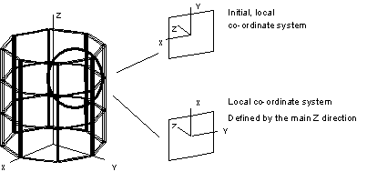

Defining vectors will define the main direction for definition of planar element calculation results. It is projected onto an element, defining the local x axis direction. The vector cannot be perpendicular to the element (parallel to the local z axis). If the vector is projected onto the element as a point, then all results will equal zero.
Typical situations are shown on the drawing below. All elements are laying on the surface of a cylinder. Initially, local x axes are parallel to the meridian. These axes will be redefined using the main direction pointed in the same direction as the global Z axis.
