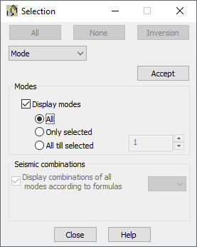

The Selection dialog selects vibration modes. It is launched by selecting Edit > Select when the Mode option is active. It is also be activated by clicking
- mode or by selecting View > Filter while in the table.
The following parameters may be selected:
- All - All modes obtained during calculations will be presented.
- Only Selected - Only the selected mode will be presented. It must be entered in the appropriate field in the dialog)
- All Till Selected - All previous modes to the one entered will be presented.
Quadratic Combinations allows for presenting all modes according to formulas specified in the SRSS (Square Root of the Sum of the Squares), CQC (Complete Quadratic Combination) method, 2SM (double sum) or 10%.
