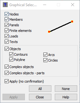

Open the dialog, which lets you specify the structure elements to highlight in the drawing area, using either method:
- Click Edit menu > Select special > Graphical selection filter.
- Click
The dialog has the following options:
Nodes
When selected ( When cleared, structure nodes are not selected in the drawing area. |
Bars
When selected ( When cleared, structure bars are not selected in the drawing area. |
Panels
When selected ( When cleared, panels are not selected in the drawing area. |
Finite elements
When selected ( When cleared, finite elements generated for a structure model are not selected in the drawing area. |
Loads
When selected ( When cleared, loads defined in the structure are not selected in the drawing area. |
Texts
When selected ( When cleared, text is not selected in the drawing area. |
Objects
When selected ( When cleared, all options connected with objects are not selected in the drawing area. |
Contours
When selected ( When cleared, contours defined in a structure are not selected in the drawing area. |
Polylines
When selected ( When cleared, polylines defined in a structure are not selected in the drawing area. |
Arcs
When selected ( When cleared, arcs are not selected in the drawing area. |
Circles
When selected ( When cleared, circles defined in a structure are not selected in the drawing area. |
Complex objects
When selected ( When cleared, complex objects created in a structure are not selected in the drawing area. |
Complex objects - parts
When selected ( When cleared, parts of complex objects created in a structure are not selected in the drawing area. |
The following buttons are at the bottom of the dialog:
- All - Selects all options in the Graphical selection filter dialog.
- None - Clears options in the Graphical selection filter dialog.
At the bottom of the dialog, there is the Apply (no confirmation) field. When selected, the Apply button is disabled. When cleared, the Apply button is enabled and options in the dialog are applied only after clicking Apply.
), structure nodes are selected in the drawing area.
