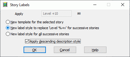

This option changes the names of stories. After you change the name of a story in the Stories dialog and press ENTER, the following dialog is displayed.
The dialog has the following options:
- Label of the selected story - Changes the name of the story you select. All other story names remain unchnaged.
- New label style to replace ''xxx'' for successive stories - The name of the story that you select is treated as a template for the stories that you subsequently define. These stories have names that contain the character string "xxx" (xxx is part of the old story name. The names of all successive stories are changed.
- New label style for all successive stories - The name of the story that you select is treated as a template for the stories that you subsequently define. The names of all successive stories are changed.
- Apply descending descrption style - Successive stories are named in descending order (using numbers or letters).
