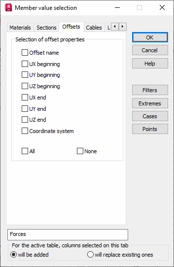

Offsets
Select the Offsets tab in the Columns dialog to select offset values for presentation.
The following values defining an offset can be selected for the table.
  • Offset name.
  • UX beginning, UY beginning, UZ beginning - Columns presenting values of offsets at the bar beginning in the direction of axis X, Y or Z, respectively, of the global co-ordinate system.
  • UX end, UY end, UZ end - Columns presenting values of offsets at the bar end in the direction of axis X, Y or Z, respectively, of the global co-ordinate system.
  • Co-ordinate system - A column informing whether the offset values are presented in the global or the local co-ordinate system.
