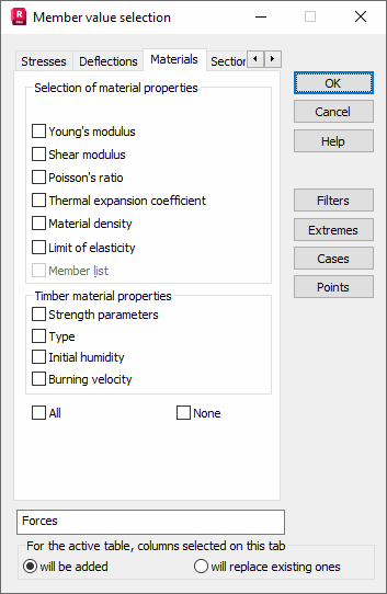

Select the Materials tab in the Member Value Selection dialog to select materials for presentation.
The following can be selected.
  • Young's modulus - a column for the Young's Modulus value for the respective structure members.
  • Shear modulus - a column for the shear modulus (Kirchoff's modulus) value of the respective structure members.
  • Poisson's ratio - a column for the Poisson's ratio value for the respective structure members.
  • Thermal expansion coefficient - a column for the thermal expansion value for the respective structure members.
  • Material density - a column for the material density value of the respective structure members.
  • Limit of elasticity - a column for the limit of elasticity value for the respective structure members.
  • Member list - a list of all members with attributed materials will be presented in a table.
