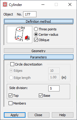

Open the Cylinder dialog, which lets you define cylinders in Robot, using either method:
- Click Geometry menu > Objects > Cylinder.
- Click
The dialog has four parts:
- Object field, which is the number of the created or selected object
- Definition Method
- Geometry
- Parameters.
When the Cylinder dialog is fully opened, clicking one of the 3 buttons (Definition Method, Geometry or Parameters) minimizes the corresponding part of the dialog so it displays only the options used at a given time. When the window is minimized, clicking one of the button extends the dialog.
Definition Method
Options for selecting the method for defining a cylinder are located in Definition Method. All available methods are based on defining 3 points which define the cylinder.
Defining a cylinder consists of 2 parts:
- Definition of the circle - the base of the cylinder
The diagrams show in general the methods for defining a circle as the base of a cylinder.
The circle is defined using 3 points on the circle. In the Geometry dialog, 3 fields: Point 1, Point 2, Point 3 are used.
The circle is defined by the center of the circle and by a point on the circle. In the Geometry dialog, Geometry Point P (the center of the circle) and Radius fields are used.
- Selecting the type of cylinder
The right cylinder
In the Geometry dialog, the Height (Cylinder Height) field is used.
The oblique cylinder
In the Geometry dialog, the Point PH (the point describing the position of the cylinder apex) is used.

Parameters
The Discretization field is in the Parameters dialog.
When Circle discretization is cleared, the circle for the base of the cylinder is created using the analytical method.
When Circle discretization option is selected, you can define parameters for dividing the circle, which is the base of the cylinder:
- Edges - The number of sides of a polygon that approximates a circle (the polygon inscribed in a circle).
- Edge length - The length of the sides of a polygon that approximates a circle (the polygon inscribed in a circle).
It also has the following options:
- Top - If selected when defining the cylinder, the object wall (the top) is created.
- Base - If selected when defining a cylinder, the object wall (the base) is created.
- Solid - Selecting this option creates a cylinder as a volumetric structure (solid). The option is available for volumetric structures.
- Side division - Specifies the number of divisions along the height of the cylinder.
- Members - When selected this option, the cylinder consists of member elements (individual parts of a cylinder will be members). When the option is cleared, a cylinder is generated as a 2D object (plate, shell) or a 3D object (solid).
