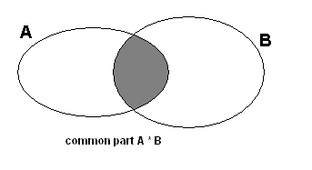

Robot indicates the overlapping parts of selected objects, which leads to the definition of the common part of the indicated surfaces (objects).
As a result of this operation, Robot generates an object that is a common part of all the selected objects. If the objects do not have a common part, an empty object list is obtained.
The operation is presented diagrammatically in the following image (in the form of an operation on sets).
