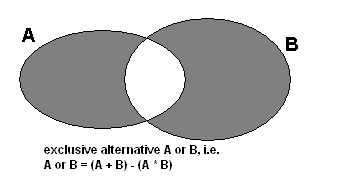

Robot creates an object that corresponds to the result of the logical operation of the exclusive alternative, defined for 2 selected objects.
The operation is presented diagrammatically in the following image (in the form of an operation on sets).
The complex object is created through the logical operation of the exclusive alternative, defined for objects grouped in operand A and in operand B. The logical operation yields the surface of objects that belong to the first and to the second operand, and not to the common part of the operands.
