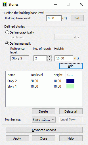

Open the Stories dialog using either method:
  • Click Geometry menu > Stories > Stories.
  • Click .
At the top of the dialog define the building base level. Clicking Set completes the definition.
In the Defined stories field is a list of defined stories. You can define a story 2 ways:
  • Graphically - after selecting this option, you can define stories left-clicking the mouse in the drawing area. The top level is entered to the edit field and a defined story is added to the list of stories.
  • Manually - after selecting this option, start defining a new story with selecting the reference level in the Reference level field, then specify a number of repetitions, height and numbering of the story (you can select one of the following: numerical numbering, numbering using letters, user-defined numbering).
To define a new story:
  1. Specify the building base level
  2. If you want stories to repeat every certain height, specify a number of repetitions and height of a story
  3. Define numbering in the Numbering field
  4. Click Insert.
To delete a story, highlight the story in the list and click Delete. To delete all stories, click Delete all.
The middle of the dialog has fields for defining the parameters for a story:
  • Story name - By default, stories are designated: Story n
  • Top level
  • Story height
  • Color assigned to a story, which opens the dialog for selecting colors
Note: To change the height of a defined story, select the story in the Object inspector pane and modify its height in the Properties field.
A story name can be selected in the Numbering field. A default name is Story n; however, you can define your own numbering for as well. To do so, use the follow the steps:
  1. Select the Define option in the Numbering field.
  2. In the field to the right of Numbering (available after selecting the Define option), specify a name (label) for the story. After you enter the name Story, the following names are generated: Story1, Story2, and so on.
  3. Click Insert.
Also, you can assign a story name corresponding to a story position, such as. 4.0, 6.5, and so on. To do so, select the Define option in the Numbering field. The %v variable in the field to the right, generates a story name depending on the position of the story.
You can change the name of a story by double-clicking the name of the story you want to change. After you change the name, press ENTER. Before Robot changes the name, an additional dialog (Story Labels) displays.
