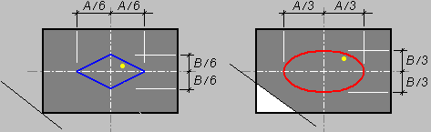

  3. EN 1997-1:2004 and ENV 1997-1:1994 (EC 7)
    Eurocode 7 imposes special requirements for foundations with a large load on eccentricity (6.5.4). It is possible to design a foundation considering the limit condition for a position of the force resultant of 1/3 of length or width 6.5.4 (1).
    Due to the danger connected with foundation uplift, it is possible to introduce a more rigorous condition for the positon of resultant, which prevents uplift (1/6 of length or width) which corresponds to the core of section. This condition may be applied in design of foundations for structures of higher importance.

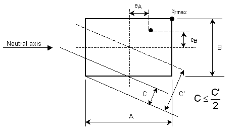

    Core I
    Core 1 prevents a gap under the foundation base, which indicates uplift. In this case the eccentricity may not exceed the values A/6 and B/6 so the neutral axis does not intersect the foundation base.
    For the foundation of industrial hall columns loaded with overhead traveling cranes, the resultant of design forces for dead, live, short- and long-term loads may not overstep the core of foundation base 2.3 d.
    Core II
    The generalized core has been introduced due to the limitation of allowable gap under the foundation when uplift of the footing base occurs 2.3 a. The code allows for the gap between the ground and the foundation base. The range of which may not be greater than half of the distance C', between the straight line that extends parallel to the neutral axis and passes through the centroid of the whole base, and the outermost point of the base which lies opposite to the point at which the maximum stress value q rmax occurs. Therefore, the allowable, relative value of a gap for core II equals 0.5 and results from the C/C' ratio. For a simple case of eB = 0, C = A/4, a C' = A/2.
