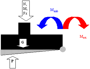

Rotation (Local Stability)
This limit state check is accessible for all codes. It determines a sum of overturning and stabilizing moments that result from all types of impact for each edge of a foundation .
Options in the Geotechnical Options dialog (on the General tab for some of the codes) enable the user to switch on the analysis of this state and to determine a safety factor for it.
