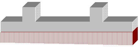

The following assumptions are adopted in calculations of spread footings with two columns.
  • Only analysis of rectangular foundations is allowed when a line passing through points of pier axes is parallel to the foundation edge.

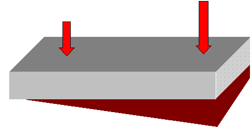

  • In soil calculations the foundation is treated as infinitely rigid, whereas the soil as linearly elastic. It is assumed that stresses in the soil can be described by means of a plane.

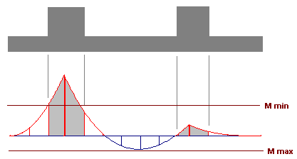

  • In static analysis the foundation is calculated as a single-span beam with cantilevers supported by columns and loaded with soil pressure. Calculations are performed independently for both directions
  • Work of the foundation treated as plate is not taken into account in calculations
  • The foundation is designed for the maximal span moment and support moment; these moments are calculated considering the support width. The occurrence of top reinforcement depends on that, whether the tensile moment acting on top fibers exists (it may as well be forced in the Reinforcement Pattern dialog box)
