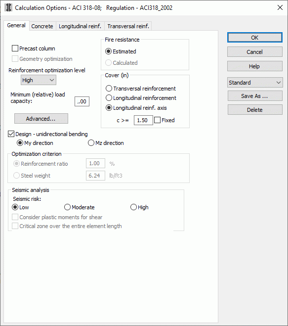

Once the Calculation Options dialog box is opened and the General tab is selected, a dialog box shown below will appear on the screen.
The above dialog box is used to set general column design options:
- Minimum Load Capacity (relative) - Ratio of percentage change (positive or negative) of the minimum load capacity in regard to required loads. If the value is set at 1.2 the load capacity will be increased by at least 20%.Setting the value at 1.0 will result in the column design due to real forces - without increasing the load capacity.A value below 1.0 decreases the load capacity.
- cover
- Lateral Reinforcement - once this option is selected, the cover is set as a distance between the lateral reinforcement surface and the external concrete surface.
- Longitudinal Reinforcement - once this option is selected, the cover is set as a distance between the longitudinal reinforcement surface and the external concrete surface.
- Longitudinal Reinforcement Axis - once this option is selected, the cover is set as a distance between the longitudinal reinforcement axis surface and the external concrete surface.
- c - the minimum reinforcement cover thickness
- Fixed - Once this option is selected, the cover thickness will remain fixed during the calculation process.
Note: The minimum value depends on the required fire rating and the exposure rating. If the Pre-dimensioning option is active the cover value is set automatically in such a way that the minimum requirements are met and the value is still no smaller than the user defined one. Once the 'c' value is fixed the cover thickness value will remain the same during calculations.In case any incompatibility to the exposure rating or the fire rating occurs, the appropriate warning will appear on the screen.
- Precast Column
- calculation of deflection (reinforcement, geometry, deflection)
- advanced
- cracking correction by increasing the reinforcement area (it refers to all the codes except for ACI, BAEL and CSA)
If the dialog box is opened for RC columns, it also includes the option for unidirectional bending. Once the Design - unidirectional bending option is activated, then a column will be designed due to the case of unidirectional bending, independently of moments defined for the other direction. It also refers to ignoring not intended moments, influence of slenderness (second order effects) etc.
Additionally, the General tab for RC columns contains the option for selection of the reinforcement optimization level (high, average, low). For the high optimization level the program searches the greatest number of possible solutions of bar distribution, while for the low level - the lowest possible number. It means that calculations with the high optimization level applied take longer than calculations with the lower level applied, however, the generated reinforcement will be the result of checking a greater number of bar arrangements to find the optimal one. It does not necessarily mean that reinforcement generated for the low optimization level is always less optimal (while for the high level - more optimal than the remaining ones), but a greater number of verified bar arrangements allows finding potentially better solutions. This option is of practical importance only for bars with a considerable number of combinations (take note that the resistance verification has to be performed for each bar arrangement and it proceeds successively for each combination).
