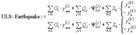

ULS:Earthquake: 4 +27 + 0 + 17
SLS:STD: 1 + 6 + 0 + 0
LRFD regulations allow for five combination types: 4 for ULS and 1 for SLS. Three types of formulas for ULS are given additional names which make their identification easier; these are: Snow&Wind, Construction phase, and Earthquake, respectively.
The ULS:Earthquake formula consists of the parts concerned with dead, live and seismic loads (for accidental loads, 0 has been entered to disregard in this combination). Taking advantage of the list of predefined components or descriptions in the regulations, the following is obtained.
A full notation of the formula for this combination is as follows.
