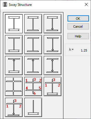

The dialog box shown below allows for the selection of the buckling model for sway structures (analogous dialog box is opened for non-sway structures). It is active once the sway structure option (for Y or Z direction) is selected in the Column Buckling Model Selection dialog box and the icon corresponding to the buckling model is pressed.
Select any icon corresponding to the column buckling model and press the OK button.

After double-clicking on the icons shown in the drawing above, the program opens the dialog box where node rigidity may be defined.
