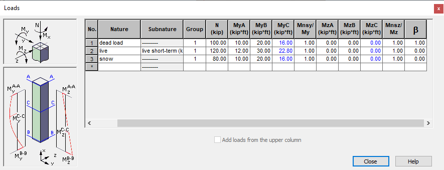

Once the option is selected, the dialog shown below will appear on the screen (the dialog below is for the ACI 318 code) .

Column loads can be defined in the above dialog box. Depending on the calculation options selected, the user may define either only the compression force (the case of the column axial compression) or the compression force, moments (the case of the column compression and bending) and shear forces (the case with shear considered). It is also possible to automatically add upper loads. If the option Add loads from the upper column is selected (√ appears on the screen) loads from the upper column are added to the loads of the current column. Added loads are saved in the first rows of the column load worksheet and cannot be edited. When the option is deselected, upper column loads are skipped during column design process.

The N column displays longitudinal forces. After importing a model to the RC module, the N column displays the greater of the values of longitudinal forces from both column nodes.
The significant step while defining loads is to correctly define moments in a column. Fields in the load table for each of directions work in the following way:
  • definition of values of moments at column ends; moments acting on the upper and lower end of the column are denoted by the symbols MA and MB; after entering a value in the upper and lower part of the column, the program calculates automatically the moment in the central part of the column, which is indicated by the symbol MC (a value of the moment is calculated according to the guidelines of a given code); a value of the MC moment is displayed in blue color
  • a value of the moment in the central part of the column may be typed in by the user independently or the moment value calculated automatically by the program.
Note: The moment in the central cross-section of the column MC is calculated automatically; it is presented in the table for each load case (it is calculated based on the moments defined on ends MA and MB). However, for an arbitrary combination of load cases the MC moment is not a simple sum of MC moments for component cases of that combination. For a given combination moments at the column ends are calculated first, and next, on their basis the MC moment in the central part of the column is calculated. Thus, moments in the central part for individual simple cases are only informatory.
The exception includes a situation when for any of the load cases the MC moment is entered manually by the user. Then, the MC moment for a given combination is a sum of component MC moments of that combination.
Values of moments at the column ends and in the central part of the column are assigned to the column cross-sections (correspondingly to the upper, lower and central ones) which are designed separately for each combination. See also: RC column design procedure
If the Shear considered option (in the Calculation Options / Advanced dialog box) is active, then after entering a moment for the selected direction (e.g. Y), the program automatically calculates a shear force so that it corresponds to the linear distribution of the moment (for the MY moment it will be Fz). The Shear considered option is available only for several RC codes.
