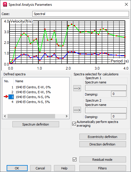

Select a spectral analysis and either click OK in the New Case dialog, or click Parameters in the Analysis Type dialog to define spectral analysis parameters for the new dynamic case is the structure.
User defined spectra are displayed in the Defined Spectra field. Click Spectrum Definition to modify or newly define spectra.
Structure spectral analysis will be performed for those displayed in the Spectra selected for calculations field. To choose a spectrum, select one of the spectra in the Defined spectra field and click the upper →. The spectrum and its damping value will be shown in the relevant fields. A diagram of the spectrum will display in the coordinate system.
Select the Automatically perform spectra averaging option to automatically interpolate spectra by selecting another spectrum. In this case, analysis will be performed for the spectrum determined based on the following formula.

The lower part of the dialog contains the OK, Cancel, Help, Direction definition, Residual mode, and Filters buttons.
