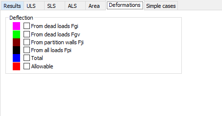

Once the Deformations tab is selected in the Diagrams dialog box accessed from the Results menu, the dialog box shown below will appear.
Note: The designations presented in the above dialog box depend on a selected code of RC structure element design.
The following values may be selected for presentation in the above dialog box:
in the Deflections field
  • From Dead Loads Fgi (short-term deflections)
  • From Dead Loads Fgv (long-term deflections)
  • From Partition Walls Fji (short-term deflections caused by a dead load applied at the time of partition wall construction)
  • From All Loads Fpi (short-term deflections caused by all loads - dead and live - carried by the element under analysis)
  • Total F = Fgv - Fji + Fpi - Fgi
in the Strains for ULS field
  • Tension Bars
  • Compression Bars
  • Concrete
in the Stresses for SLS field
  • Tension Bars
  • Compression Bars
  • Concrete
Note: A representative color for presentation in the diagram is displayed beside the corresponding value.
