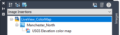

If the Image Manager toolspace is not open, on the ribbon, click Raster Tools tab Manage & View panel Manage.
In Image Manager, select the Image Insertions view from the drop-down list.
3

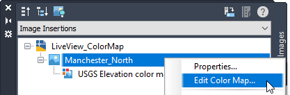

In the Image Insertions view, expand the LiveView_ColorMap node, right-click the image name and choose Edit Color Map.

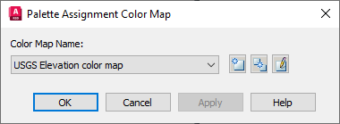

In the Palette Assignment Color Map dialog box, click to edit the color map.
5

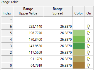

In the Palette Color Map Definition dialog box, in the Range Table, note that each color on the map represents an elevation range of 26.387 m.
Click OK to close the dialog box.

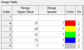

In the Palette Assignment Color Map dialog box, select Slope Color Map from the drop-down list, and then click Apply.
The colors on the map now show ranges of ground slope values.
7 Click to view the Range Table for this color map. Note that each color represents a slope range of 7 degrees.
