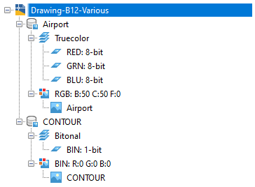

The tree view can display six object types:
Image data definition
Band group
Band group metadata
Data band
Color map
Image insertion
As shown in the figure, each data definition includes one or more band groups (examples: Truecolor and Bitonal) with subordinate bands. At the same level as the band groups are color maps (examples: RGB and BIN). Image insertions are placed subordinate to the color maps that define them. The location of the image insertion on the tree is a major difference between the Image Insertions view and the Image Data view.
