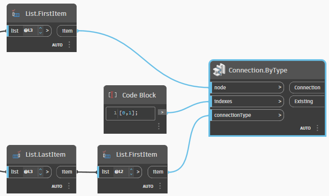

4. Prepare filtering results for connection placement
For each item in the resulting list we need to take the first element as the ConnectionNode, and the second element as the list of applicable connection types. We can do this by using List.FirstItem to get the ConnectionNode and List.LastItem to get the list of connection types that have ranges validated for the ConnectionNode.
Note: We recommend to do a List.Clean before in order to work with a clean list and avoid warnings.
Secondly, from the list of applicable connection types we want to chose the first one. We do this by another List.FirstItem.
In this way we will place in our model the first connection type in the previously alphabetically sorted list that has its ranges validated for each specific situation (connection node).
5. Create the connection
The Dynamo node that you need to add to the script is Connection.ByType. This node is used for placing connections.
Connect the output of the first branch, of the List.FirstItem node, to the first input of Connection.ByType node.
Connect the output of the second branch, of the List.FirstItem node, to the last input of Connectin.ByType node.
Note: The indexes, that is the middle input, need to be the same as at step 3, the validation step.
