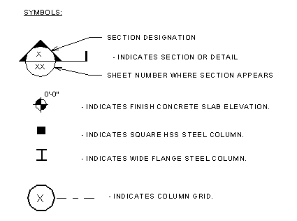

In a construction document set, you can include the following types of legends:
  • Component legend: A list of components used in the building model, with details about their structure, representation in drawings, or visual appearance.
  • Keynote legend: A list of keynotes used to document the building model.
  • Symbol legend: A list of the symbols that are used in drawings.
Example of a symbol legend
Example of a structural symbol legend
