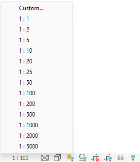

    • Change the scale of the view. On the View Control Bar, for Scale, select the desired scale.
