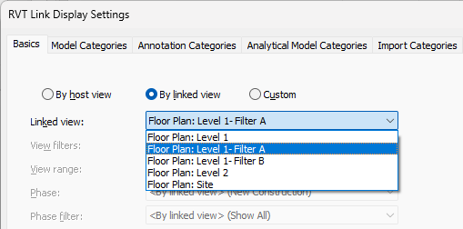

  4. In the RVT Link Display Settings dialog, on the Basics tab, do the following:
    1. Select By linked view.
    2. For Linked view, select the view in the linked model whose display settings you want to use for the linked model in the current host view.
    For example, if the selected view has a filter applied, then that filter will apply to the linked model in the current host view, too.
  5. Click OK twice.
