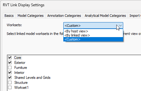

When a workshared model is linked to another model, you may want to control whether worksets from the linked model display in a view of the host model.
Use the Worksets tab on the RVT Link Display Settings dialog for the host model. On this tab, you can select the specific worksets to display in a view of the host model.
