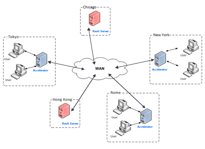

Revit Server enables server-based worksharing, in which geographically dispersed project teams can collaborate on the same model across a WAN. As shown below, multiple team members in multiple local sites use Revit Server Accelerators to connect to one or more Revit Servers across a WAN.
Server-based worksharing across a WAN
