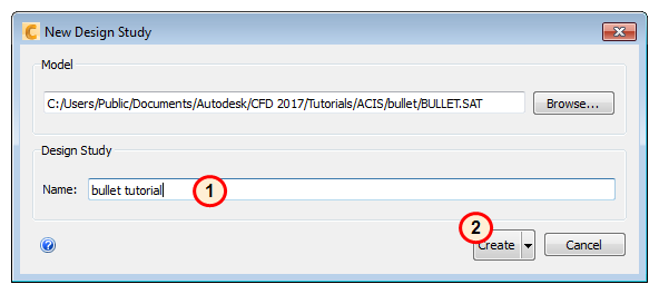

Step 2: Select the model file
On the New Design Study dialog, click Browse.
On the File manager dialog, navigate to Users\Public\Public Documents\Autodesk\CFD 2023\Tutorials\<file type>\bullet.
Notes:
- <file type> is ACIS or Parasolid.
Click Open.
Step 3: Create the Design Study
- Enter a Name for the new design study. This can be anything you want.
- Make sure that Create is the active option on the button, and click Create.
Autodesk® CFD starts, and creates the Design Study for the tutorial.
