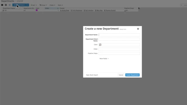

Create Departments
Departments in Flow Production Tracking should mirror the departments in your studio.
You can create Departments on the Departments page. Select Add Department and in the pop-up, name the Department, provide a Department short name, set a color, and add any appropriate people. You can also configure other fields, like Order, which determine the order Departments appear in the Resource Planning views.
Tip:
You can create and update Departments in bulk using the Importer. Download a CSV template to get started.

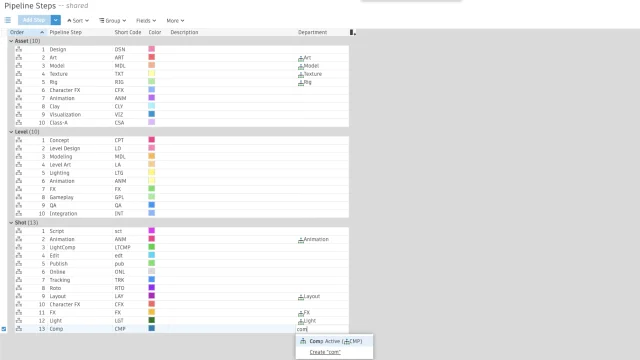

Pipeline Steps are used to connect Tasks to Departments, in order to determine the Workload of each Department.
Link each Pipeline Step to a Department on the Pipeline Steps page. If the Department field is not visible, you can add it using the Fields Menu.
Video Thumbnail
Note:
A Department can be linked to multiple Pipeline Steps, but a Pipeline Step can only be linked to one Department.
