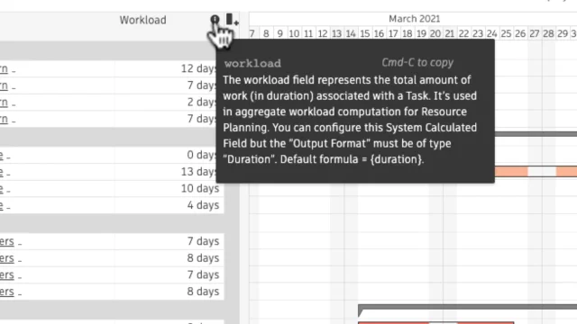

Workload represents the amount of work planned in a given time period and is based on all the scheduled Tasks. This will be shown in charts and tables in Person Days and is designated by a new Task-based calculated field called Workload. Since the Workload field is on the Task entity, it is accessible on any Task page.

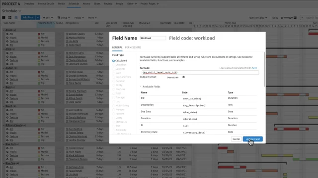

Configure the formula for the Workload field
By default, the Workload field formula pulls in the Tasks Duration field, which is a good recommended starting value. Instead of using Duration, you can configure the formula of the Workload field to take into account one or several Task fields that represent Workload in your studio, such as Bid. Or perform calculations using several fields, such as: Bid - Time Logged.
This provides a lot of flexibility. For example, you can decide whether Workload represents the planned schedule, or the difference between how the schedule was intended to run and how it is currently running.

Here is an example of how the Workload field can be configured (based on a custom field):
