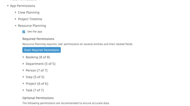

Permissions are configured on the Admin Menu > Permissions - People page. The Resource Planning section can be found under (Role name) > App permissions.
To allow roles to see the Resource Planning app name in their toolbar, toggle See the app.

Required Permissions

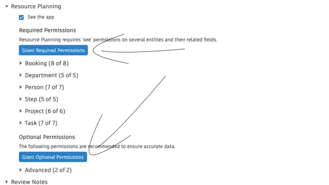

Resource Planning requires ‘see’ permissions on several entities and their related fields to function. Expand or collapse each section to see the related Entities and Fields and check the ones you want to grant view permission. You can also use the "Grant Required Permissions" to perform this operation.

Optional Permissions
Access to See all Projects and Show Non-Project Tasks can optionally be enabled so all the Tasks are accounted for in the Studio Overviews and Department data. Otherwise, Flow Production Tracking will calculate this information while respecting user specific Project “see” permissions, which can lead to different Workload values for different users.
Note:
When a user does not have all the Optional Permissions turned ON, a banner will appear to remind them.
