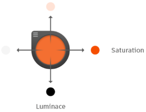

Using the Color Puck
If the puck is not visible, to access it, select Window > Color Puck. Tap-drag right and left to quickly change the saturation.
Color Puck saturation
Tap-drag up and down to quickly change the luminance of the color.
Color Puck luminance

Using the Color Puck for Windows 10
Create the perfect color with the Color Puck.
Color Puck - changing saturation and luninance
In the Color Puck, tap-drag right and left to quickly change the saturation or up and down for luminance.
