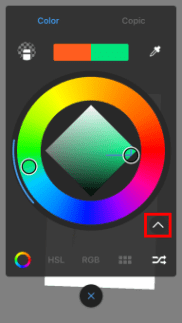

    For handheld device users:
  2. Tap Randomize icon in the mobile version of Autodesk SketchBook.
    For handheld device users, you need to then tap ^ to access the sliders.
    Accessing the Randomize sliders in the iPhone version of Autodesk SketchBook

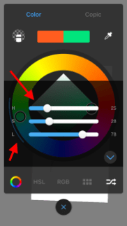

  3. Use the sliders to set the following:
    • Hue Randomize – to set the color range of the stroke.
    • Saturation Randomize – to set the range from pure color to gray of the stroke.
    • Luminance Randomize – to set the range of color brightness of the stroke.
    For handheld device users, notice how the slider panel fades as you move the sliders, so you can see the randomized range.
    Using the Randomize sliders in the iPhone version of Autodesk SketchBook
