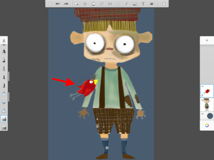

Reordering layers in SketchBook Pro Mobile
  1. In the Layer Editor, tap a layer to select it.
  2. Tap-hold and drag the layer above or below a layer into position.
    Rearranging files in Autodesk SketchBook on mobile

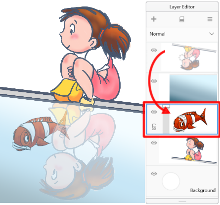

Reordering layers in SketchBook Pro Windows 10
  1. If the Layer Editor isn’t already displayed, tap UI Toggle - reordering and select Layer Editor.
    In the image below, the fish appears above the water. We need to fix this. Reorder the layers to place the fish below the water. You’ll notice that the current layer is highlighted.
    Reordering layers original
  2. Tap-hold on the layer to select it, then drag it into position.
    The fish now looks like it lives in the water.
    Reordering layers finished
