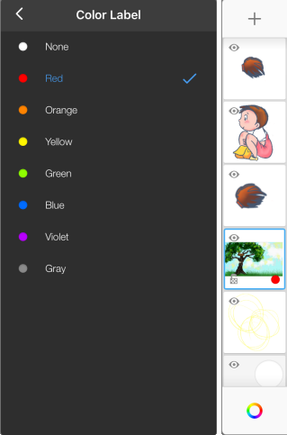

Visually organizing layers in SketchBook Pro Mobile
Tap a layer to open the Layer menu. At the bottom of the menu, tap Color Label and select a color from the list. Now, a colored spot appears in the lower right corner of the layer, making is easier to distinguish it from the others.
