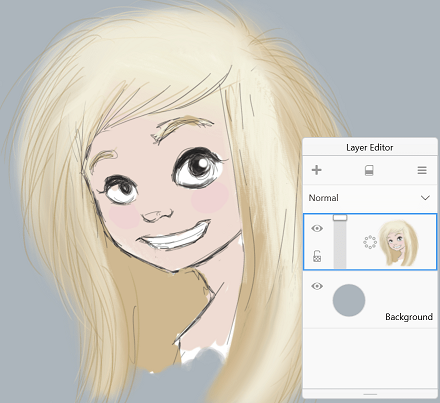

Setting the background color for Windows 10
In the bottom layer of the Layer Editor, tap Background Color icon to access the Color Editor and set a background color.
Background color - Color Wheel Background Color
