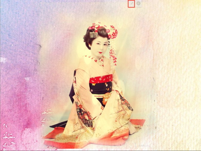

When working in Autodesk SketchBook Motion, there will be times when you will want to hide UI elements. An example is when you are showing your scene to a coworker, but will continue to work on it. You want them get the full effect, without the UI distracting them. Turn off the UI, so your work is the focal point.
Use
Fullscreen mode to go between full screen with no UI and regular view, which displays the UI.
Hiding all the UI
In the toolbar, tap
to hide the UI.
When you want to get back to working on your scene, in the toolbar, tap
to display the UI again.
If you display the UI and you still can't find something, such as your pucks, see Basic UI elements. In the Desktop versions, all UI can be toggled on and off using options in the Window menu.
