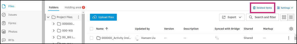

Click the Files tool.
Click Deleted items.

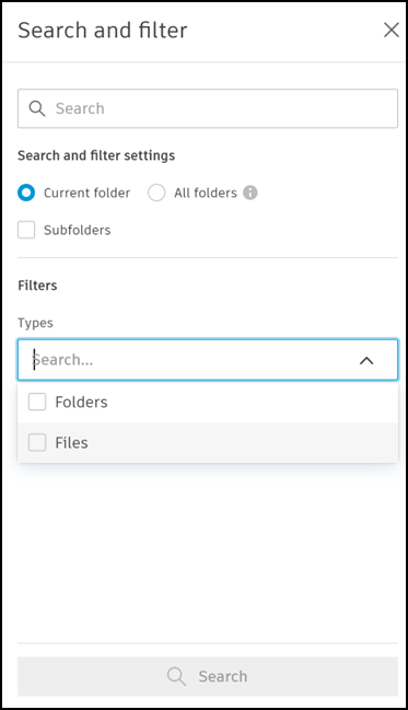

This opens the Search and filter panel.
Enter search terms to search the name and file name of the deleted item or items. Select which folders to search, and add filters if necessary.
- Current folder: You can choose to search only the current folder, or select Subfolders as well to search the current folder and its subfolders.
- All folders: Select to search all folders you can access in the project.
- Types: Filter by files or folders.

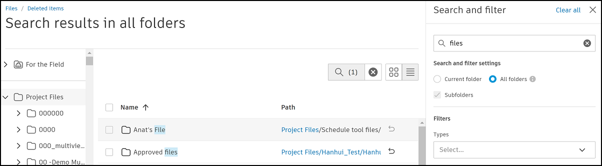

Click Search.
The search results will display the following information: Name, Path, File name, Deleted by, and Deleted date. Click the X in the Search and filter panel to close the panel if you want to view all the information. The search terms are highlighted in the name results.
Restore Deleted Items in Search Results
If you see a file or folder that you want to restore in the search results, you can click the restore icon if it's enabled. The file or folder will restore to the location detailed in the Path column.

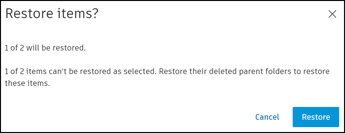

If the restore icon is disabled , this means that the file or folder wasn't directly selected for deletion. You will need to restore the folder or folders which contained the file or folder which was deleted.
Hover the disabled restore icon to view the name of the parent folder you need to restore.
If you select multiple files and folders, any which have disabled restore icons won't be restored.
